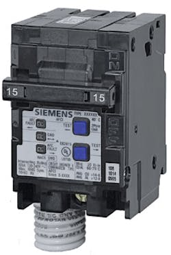

Siemens new 2-pole combination-type arc fault circuit interrupter (CAFCI) reduces wiring costs and installation/ troubleshooting time

Currently the only product of its kind on the market, the device assists users in distinguishing between line-to-neutral arcs, line-to-ground arcs, and series arcs via LED indicators that appear for 5 sec each time the AFCI is turned on up to 30 days after the last trip.
“LEDs located near the breaker's handle define what type of arc fault condition is occurring,” explains Josh Angel, Siemens' distributor sales engineer. “One LED lights up if the last trip occurred because of an arcing fault. The leg that the arcing fault was detected on can be confirmed based on which single LED was illuminated. No indication is displayed if the AFCI trips due to an overcurrent condition.”
