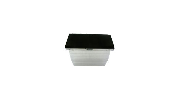

    A suitable replacement for metal-halide fixtures, this LED parking garage luminaire features 30% more light in the 60° to 80° zonal region
    May 30, 2012
    A suitable replacement for metal-halide fixtures, this LED parking garage luminaire features 30% more light in the 60° to 80° zonal region, and less than 25% light lost above the 70° to 80° plane. Available in two versions,
    the 40W LED model delivers 2,640 lm at a 5,000K color temperature, while the 70W model delivers 4,200 lumens at a 5,000K color temperature. The luminaire offers a 50,000-hr life and does not emit UV or IR rays, according to the company. Additional features include a self-contained LED driver running on 120V to 277V electrical systems and a cast-aluminum one-piece housing that is polyester-coated, protected from rust and corrosion, with a shatter- and UV-resistant polycarbonate lens.
