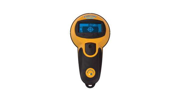

Suitable for locating rebar and copper pipe in concrete up to 8 in. thick, the MetalliScanner x8 metal finder features three sensitivity levels for easy unit of measure selection.
The MetalliScanner x8 metal finder locates and determines the depth of ½-in.-diameter rebar
and ½-in.- diameter copper pipe up to 8 in. deep and automatically differentiates between ferrous (steel, iron) and non-ferrous (aluminum, copper) metal. The finder incorporates three sensitivity levels for easy unit of measure selection and features glide pads, instead of rollers, allowing the unit to scan horizontally and vertically. Additional features include a lightweight ergonomic design, large backlit transflective display, integrated marker system, and pivoting handle attachment.
