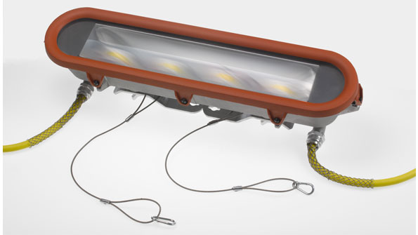

The Woodhead wide-area portable LED luminaire is suitable for use in Class 1, Division 2 locations. The luminaire delivers 5,270-lm output lasting 50,000 hr and offers instant-on capability in extreme temperatures of -40 to +40°C. Features include a cast-aluminum enclosure with a rubber lens-gasket assembly that makes the mercury-free product resistant to shock, vibration, impact, and the intrusion of dust and water.  Other features include a 5,100K color temperature, CRI of 87, a removable diffuser under the lens, a versatile mounting system, and a variety of electrical cable options, including Brad power cordsets for Zone 2 environments.
