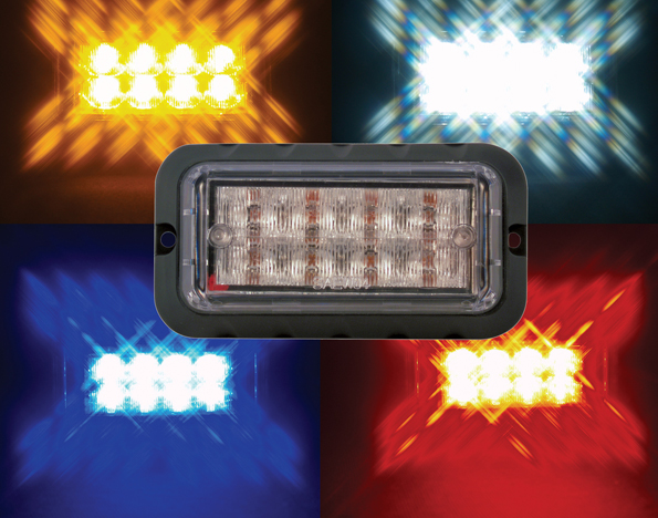

Wide-angle lens Operate as single unit or synchronized with up to four units Rated for indoor and outdoor use
LP8US surface-mounted LED luminaires feature a wide-angle output lens cover that is available in blue, red, yellow, and clear. Designed to be operated as a single unit or synchronized with up to four units, the products can be quickly programmed from a selection of 33 different simultaneous or alternating flash patterns covering a range of flashes/minute variations. Rated for indoor and outdoor use, the sealed design provides operation in temperatures ranging from -40° to 65°C (-40° to 149°F). Measuring 4.79 in. × 2.66 in. with a recessed depth of 1.31 in., the CA Title 13 compliant and SAE J595 certified luminaires are rated for 10VDC to 30VDC operation, with 1.1A (max) current draw.
