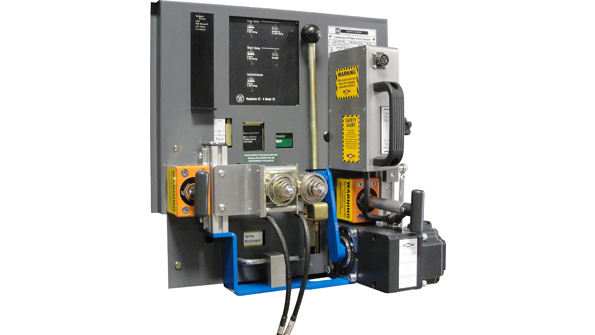

The RSA-12A is a custom-built remote switch actuator that remotely operates all styles of Westinghouse/Cutler-Hammer DS/DSL power circuit breakers. Designed to operate on equipment with manual or electric charging mechanisms, the actuator is compatible with all manufacturers and sizes of DS breakers without any modification to the breaker. When accompanied by one of the company’s applicable remote switch operator (RSO) control units, the device provides remote CHARGE, CLOSE, and OPEN operation up to 300 ft away from the equipment. Features include adjustable fittings and magnetic latching configurations. Options include a radio remote with range of up to 150 ft, 24VDC LED light, wireless video camera system with LCD monitor, and Pelican case assembly.
