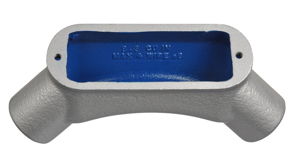

    T&B Rigid Fittings BlueKote Universal Conduit Elbow (LU) Form 8 replaces four conduit body configurations. The conduit elbow enables fiber-optic cable to be run in a ¾-in. system, instead of a 2-in. system, and still maintain the cable bend radius. An angled covered port facilitates wire pulling and uses standard covers. Because the product is UL-listed as an enclosure, splices are permitted inside of it. In addition, it is rated for 40% wire fill, avoiding the need to de-rate the system.
