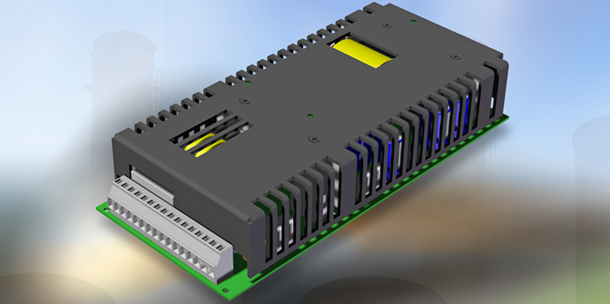

The PRP-260 Series of pure sine wave inverters provides up to 260W of power in a compact chassis-mount package. Offered in versions that comply with industrial (EN60950) or rail (EN50155) standards, input voltages of 12VDC, 24VDC, 48VDC, 7VDC2, and 110VDC are inverted to adjustable 120VAC or 230VAC outputs that are regulated to 4% or better. Output frequency can be set to 50Hz or 60Hz, and input and output are galvanically isolated. Standard features include overload protection, output failure alarm, remote inhibit, and high efficiency up to 90%. An operating temperature of -25°C to +55°C at full load allows for installations in extreme conditions and complies with EN50155 Class 3.
