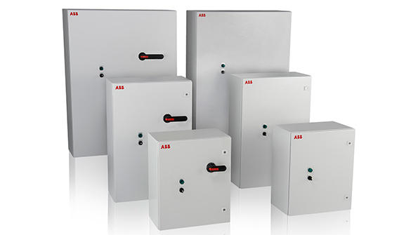

2-phase torque control Built-in bypass contactor Built-in electronic overload for motor protection
The enclosed PSE softstarter, whose sizes, ranges, and options can be selected and made to order via the company’s LP product configurator, includes 2-phase torque control and built-in bypass contactor. Featuring built-in electronic overload for motor protection, the softstarter offers a range of 5 hp to 300 hp with maximum UL ratings to 65 KAIC. The LP product configurator allows online design and is based on easy selection of the appropriately sized PSE softstarter. Through radio dials, the user enters line voltage, motor full-load amperes (FLA), and circuit protection, if required. Additional factory modifications and options are also available.
