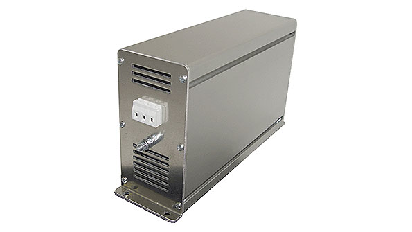

Enables suppressed interference on line cables to the motor Enables suppressed interference to earth conductors and feeds incurring bearing currents into the DC-link Conforms to EN 61558-2-20
Jan. 14, 2015
The Sinus Filter Plus ++ is designed for use in applications that require safe mechanical continuous power and reliability. The filter enables suppressed interference not only on line cables to the motor, but also to earth conductors and feeds incurring bearing currents into the DC-link so that these may not cause any damage to the mechanical system. Conforming to EN 61558-2-20, the product has a rated voltage of V=3x500V and insulation material class of T40/B.
