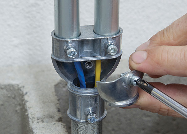

Save time and material when joining two lengths of EMT conduit into one Offered in two models Single set-screw inspection cover provides easy access to cables or conductors
March 24, 2015
Mighty-Merge Two-to-One EMT couplings are designed to save users time and material when joining two lengths of EMT conduit into one. The cULus-listed fittings are suitable in applications where: limited knockout space is available entering an enclosure or panel, to isolate circuits, coordinate installation speed up and down block wall construction, in an OEM design requiring tight parallel raceway management or in place of pull boxes and supports. In addition, the couplings’ single set-screw inspection cover provides easy access to cables or conductors. The 4256-DC model joins two ½-in. EMT to one ¾-in. EMT, while the 4258-DC model joins two ¾-in. EMT to one 1-in. EMT.
