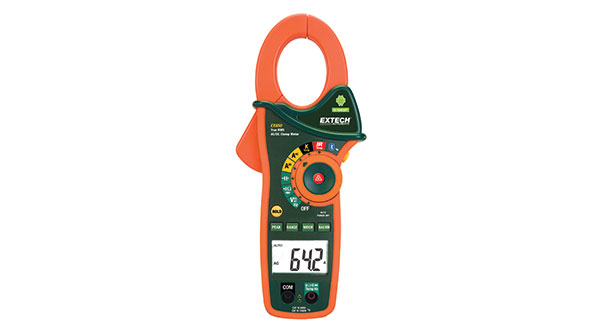

1,000A AC/DC CAT IV clamp meter Built-in infrared thermometer 1.7-in. (43-mm) jaw opening
The EX850 is a 1,000A AC/DC CAT IV clamp meter with Bluetooth technology and a built-in infrared thermometer. With the company’s ExView- app and the clamp meter, users can remotely view and display readings from the meter on an Android phone or tablet up to 10 m (30 ft) away. Advanced true rms meter functions include AC/DC current, voltage, resistance, capacitance, frequency, infrared, and contact temperature, diode-test, and continuity check. The fast-responding peak hold function captures inrush currents and transients, while a 4-digit, 4,000 count backlit display is complemented by several one-button functions, including data hold, min/max, and selectable auto- or manual-ranging. The 1.7-in. (43-mm) jaw opening handles conductors up to 750MCM or multiple conductors such as two 500MCM.
