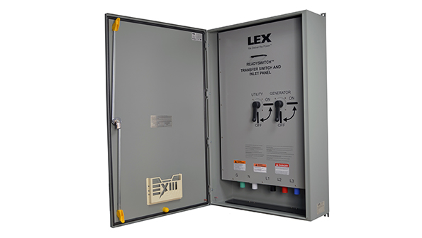

The PowerGATE ReadySwitch power input panel features an integrated manual transfer switch for emergency power management. During a power outage, the switch can be easily paired with a portable generator. Two configurations offer a choice of either service entrance rated or switched to work in conjunction with existing main disconnect. Both options feature 400A, 3 Phase, (H, H, H, N, G) 4 Pole, 5 Wire, 600VAC Maximum service. Other features include a 35 kA SCCR at 480VAC and 25 kA SCCR at 600VAC, keyed front door, inward opening cable door that prevents access to the terminals while in use or dormant, dead-front panel, and large graphic labels that clearly identify the operations and connections.
