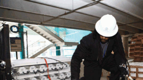

“Atlantic Station features one of the largest — if not the largest — enclosed parking decks in the Southeast,” notes Chris Rogers, CEO and president of Alpharetta, Ga.-based Rogers Electric, the electrical contractor that performed the lighting retrofit. “The garage contains 7,200 spaces spread out over three levels. Over a 15-week period, eight members of our team worked five days a week to remove the existing HID lamps and retrofit them with T5 lamps. It was a one-for-one swap. We performed this on approximately 3,000 luminaires.”
Although the project sounds straight forward, it wasn’t without difficulties, according to Rogers.
“The retrofit started at the end of September and continued through the Thanksgiving and Christmas seasons, with a December 31 finish,” he explains. “Our biggest challenge was staying on schedule during the busiest shopping time of the year at one of the most popular retail venues in Atlanta. Ensuring that power to the luminaires we were retrofitting on a given day was turned off was also extremely important, in addition to delivering materials in a timely manner to the correct areas.”
Because the parking deck is open 24 hours a day, 365 days a year, closing large sections of the garage while retrofitting the luminaires wasn’t an option. This forced Rogers Electric employees to work in cordoned-off areas still accessible to vehicles. To ensure its employees and the Atlantic Station patrons remained injury free, the electrical contractor held regular safety meetings and kept a project manager on-site at all times.
“To further limit the risk of injury and the impact of the parking deck’s operations, we worked from midnight to 10 a.m.,” Rogers says. “These unconventional hours made this project pretty unique for us. Another unique aspect was the fact that we performed the new construction build on the original parking deck back in 2002. Getting to do a reinstall on our original work as lighting technology continues to advance isn’t something we experience all that often.”
