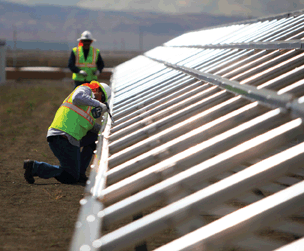

“Our Energy Alternatives Division engineered and built two ground-mount solar farms totaling 35MW as part of the first phase of PG&E’s multi-year 250MW solar initiative,” says Tim Jensen, project executive for San Jose, Calif.-based electrical contractor Cupertino Electric Inc. (CEI). “The farms are located at separate sites in western Fresno County approximately 12 miles apart.”
Situated on 100 acres, the 15MW Westside solar station features 66,240 fixed-tilt polycrystalline 275W and 280W solar modules while the 20MW Stroud location encompasses 123 acres and includes 88,000 fixed-tilt polycrystalline 280W solar modules. Both generation plants employ 500kW inverters and are interconnected to the electric grid — with the approval of California’s Independent System Operator (CAL-ISO) — at local PG&E distribution stations.
