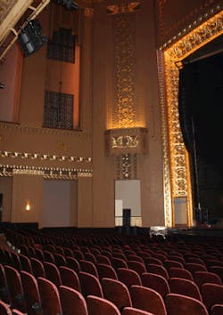

Situated in downtown St. Louis, the Peabody Opera House is a 3,500-seat historic theater that has hosted the likes of Frank Sinatra, Ray Charles, and the Rolling Stones. The Art Deco building, formerly known as the Kiel Opera House, was originally constructed in 1934 and operated continuously until it closed in 1991. Thanks to a recent $78.7-million restoration project, the Peabody Opera House has been returned to its former glory and is once again a popular performance attraction.
