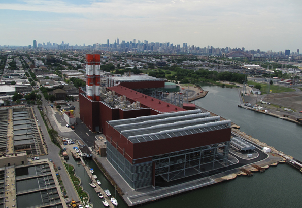

Over the last 12 years, New York State has added almost 9,200MW of electric generation, according to “Power Trends 2012: State of the Grid,” a report published by the NYISO. It should hardly come as a surprise that more than 80% of this new generation is located in the Big Apple — America’s most populous city. To help power the densely inhabited metropolis, Astoria Energy, LLC recently constructed a 550MW natural gas combined-cycle power plant in the borough of Queens, N.Y. Operating adjacent to yet separately from the six-year-old Astoria Phase I power plant, the Astoria Phase II was a multi-million dollar undertaking that resulted in one of the state’s cleanest power plants.

Like Astoria Phase I, Phase II includes a steam turbine generator, two combustion turbines, and two heat recovery steam generators (HRSGs).
“Operations are run via a control room that we originally built during Phase I,” explains Brendon Bergin, senior project manager for E-J Electric. “During Phase II, we expanded and updated the control room, because it contains equipment for both sectors of the plant. Both phases contain a load-commutated inverter that ties the plants together. Each inverter is capable of starting the turbines, which are enclosed in a 97,000-sq-ft steel-framed structure, for Phase II as well as those located at Phase I.”
According to Kregel, the fast-track and tightly sited project, which broke ground in 2009, required his company to perform a large amount of preplanning, such as 3D modeling, along with prefabrication of some major equipment. For example, the HRSGs, air-cooled condenser, and pipe racks were assembled off-site and then transported by barge to Phase II once they were ready for installation.
“Needless to say, constructing a power plant on just 7 acres in the middle of one of the nation’s most densely inhabited neighborhoods presented some major challenges,” says Kregel. “We had very limited laydown area, which meant we had nowhere to store anything. This resulted in many just-in-time deliveries that were basically being installed as they were arriving.”
