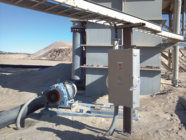

The slurry tank shown in the background is where sand and water are combined to create the pumpable slurry mixture that is sent from the mine site down to the wet plant for processing.
The wet plant, located near the mine site along the river canal, pumps dredged sand from the mine site through its processing equipment and then up to the dry plant storage location. At the wet plant, the company begins the process of sorting the sand and disposing of the substandard sand. Later on in the process, the company sorts the sand further into specific grades and ships it out, depending on clients’ needs.
