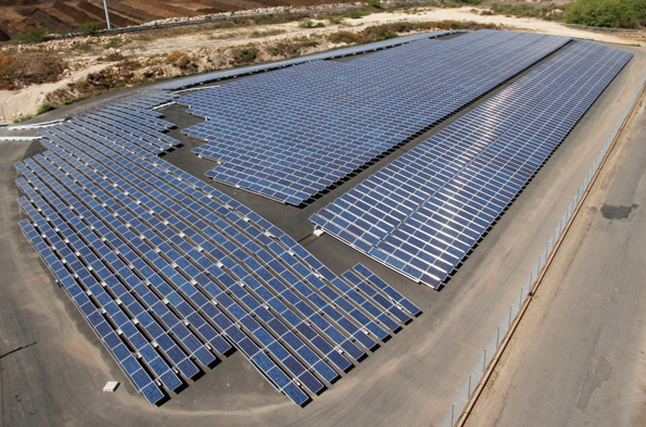

    Photovoltaic (PV) panels are generating clean, green electricity on top of an existing hazardous waste site on the island of Oahu. Seven acres of land, once thought to be undevelopable, are now home to the island’s first utility-scale PV solar energy facility.
    The U.S. Environmental Protection Agency halted dumping on the industrial disposal site in 1986. The site was then sealed under a plastic liner and thick mound of asphalt. Twenty-seven years later, a design and construction team has transformed the site into the Kapolei Sustainable Energy Park.
    At the utility-scale solar field in Kapolei, Hawaii, the 1.18MW ground-mounted PV system generates enough power to supply 150 to 250 homes.
    The Kapolei Sustainable Energy Park is producing clean, alternative energy for the residents of Oahu, Hawaii.

    To successfully install the PV system, the companies had to follow many guidelines aimed at protecting the environment. One of the most significant challenges was that instead of building the PV system on a flat open field as in most utility-scale solar projects, the workers had to construct the system on top of an asphalt mound.
    Because the cap protected the hazardous industrial waste contained beneath, the field workforce had to avoid penetrating or puncturing it in any way. For example, their construction equipment had to meet certain weight restrictions and feature tracks rather than hard, rubber wheels.
    An independent environmental consultant continually monitored the condition of the asphalt cap throughout construction for excessive wear or damage. This consultant also monitored the underground activities required for the distribution portion of the project and sampled the soil conditions.
    Shortly after preliminary excavation commenced, elevated levels of lead were discovered in the soil adjacent to the cap. Additional safety, monitoring, and abatement measures were then employed to complete the work in a safe and environmentally controlled manner.
    Due to environmental findings, the companies had to be flexible and adaptable to changes in the design, particularly after the equipment was procured, says Lyman Morikowa, principal engineer for Morikowa & Associates in Pukalani, Hawaii. For example, the team had to redesign and relocate the 12.47kV electrical service from underground to overhead to minimize the need for excavation and handling after discovery of contamination.
    The Hoku Solar and Morikawa & Associates, LLC team also worked on solving the non-penetration design challenges of the PV array field, equipment layout, and system grounding.
    Because the sides of the cap were sloped, it also posed challenges in the safe handling of material on the site and installation of the racking and PV modules on the existing sloped surface. Because the protective asphalt cap could not be penetrated, Helix worked with the other firms to design a racking system that could be anchored to surface-mounted concrete ballasts.
