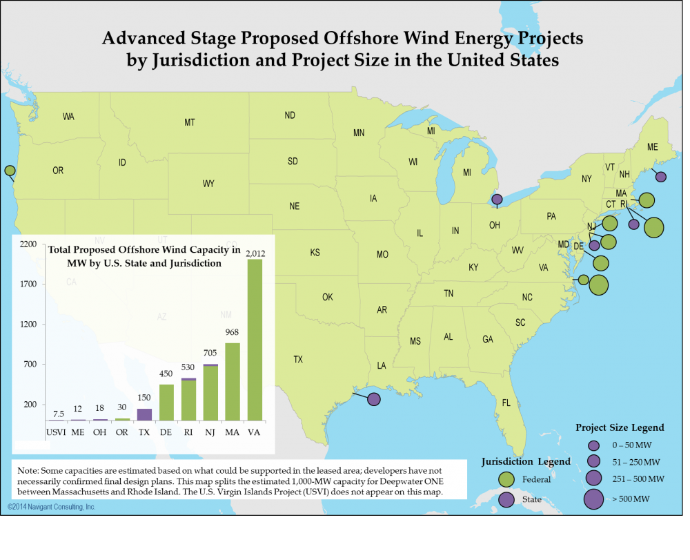

The Energy Department has announced a new report showing steady progress for the U.S. offshore wind energy industry over the past year. The report highlights 14 projects in advanced stages of development, together representing nearly 4,900MW of potential offshore wind energy capacity for the United States. Further, this year’s report highlights global trends toward building offshore turbines in deeper waters using larger, more efficient turbines that increase the amount of electricity delivered to consumers.
This year’s Offshore Wind Market and Economic Analysis, produced by Navigant Consulting for the Energy Department, found that there is significant potential to increase U.S. electricity capacity and create jobs through the further development of the U.S. offshore wind industry, and it also outlines policy developments that are influencing the offshore wind market.
The 14 U.S. projects examined in the report can now be considered in advanced stages of development, meaning they have either been awarded a lease, conducted site studies, or obtained a power purchase agreement. As these projects continue to advance, they will provide valuable data that will support the growth of the country’s emerging offshore wind industry.
The report also finds that globally, developers continue to build offshore wind projects farther from shore in increasingly deeper waters, while increased turbine sizes and hub heights enable higher efficiency and output from turbines. Worldwide, the average capital cost for offshore wind projects completed in 2013 fell 3.7% per kilowatt-hour from 2012, with an additional decrease expected in 2014. Total project installation costs have fallen 6% since 2011.
The Energy Department today also announced the first National Offshore Wind Energy Grid Interconnection Study, prepared for the Department by the ABB Group. The study investigated the key economic and technological factors that will influence the integration of offshore wind energy onto the national grid. The findings suggest that the U.S. has sufficient offshore wind energy resources to enable installation of at least 54GW of offshore wind capacity — enough to power nearly 17 million homes — and that the appropriate transmission technologies already exist to connect this offshore wind energy to the grid.
