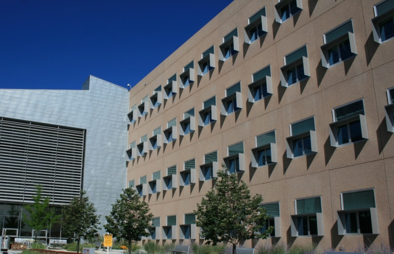

Bill Gillies, NREL
NREL Research Support Facility
