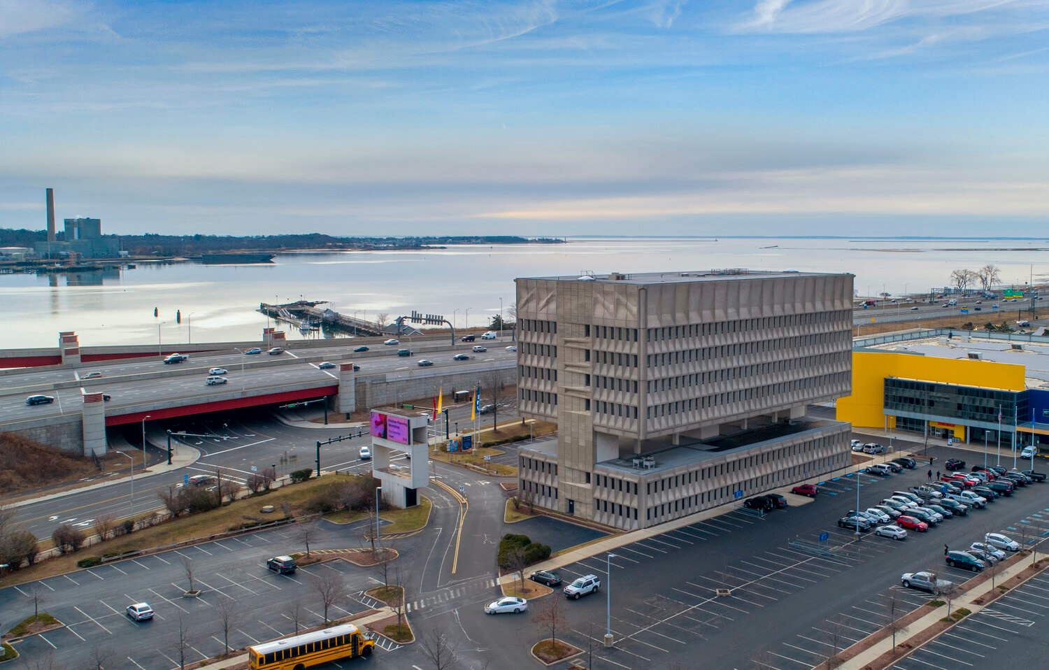

The Hotel Marcel New Haven, in New Haven, Conn., was set to welcome its first guests the week of May 15, two years after work began to transform an existing building into a showcase for sustainability in an industry that has been slow to join the green building movement.
The new hotel, in a 52-year-old building listed on the National Register of Historic Places for its origins in modernist design, counts on-site solar energy sources; battery energy storage; electric vehicle (EV) charging; and low-voltage Power-over-Ethernet (PoE)  lighting among features that will contribute to making it function as an all-electric, energy-sipping, net-zero-energy (NZE) structure.
According to a news a release from Hilton Hotels & Resorts, which has a stake in the property through its Tapestry Collection brand, the building is believed to be the first NZE-designed hotel in the U.S. and one of only a handful of hotels in the country built to energy-saving LEED Platinum standards. As with all NZE buildings it will take about a year for certification body New Buildings Institute to analyze building energy usage to confirm zero-carbon-emission status.
More than 1,000 solar panels mounted on the roof and parking canopies will provide power for the hotel, and a 500kW  battery system will store energy for emergency backup power and possibly load shifting, according to an article on the project in Green Lodging News. Bruce Becker, head of Westport, Conn.-based design firm Becker + Becker, whose purchase of the iconic building sparked the development, was quoted as saying the 110,00-sq-ft building’s solar panels, which he purchased, are projected to supply about 700,000kWh per year of electricity, 20% of what a comparably sized hotel now uses annually.
