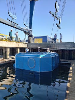

CalWave Power Technologies, Inc., Oakland, Calif., said on September 1 that a submersible device it engineered to generate power from waves demonstrated strong viability during a 10-month deployment in San Diego coastal waters.
The device, employing the company’s patented xWave technology, generated power and data that was transmitted via undersea cable to the nearby Scripps Institution of Oceanography research pier. Preliminary test results confirmed many key aspects of the design, including demonstration of extensive uptime, the ability to withstand heavy seas, autonomous operation, corrosion resistance, and safety. Data from the test will be further analyzed, but the company said the pilot indicated its system is effective for overcoming the key challenges of performance, reliability, survivability, and cost.
