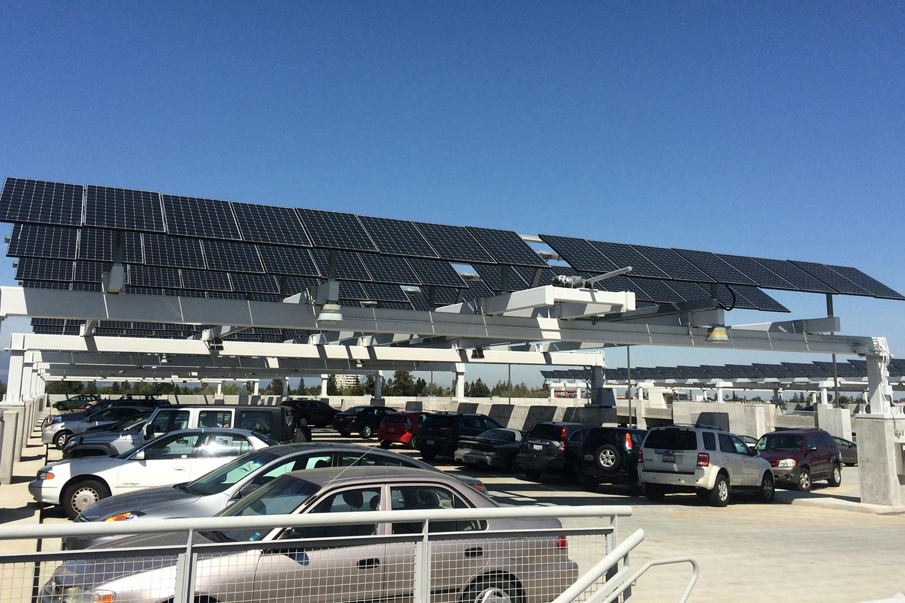

Available space is another important consideration. PV systems that do not fit well on the roof of a lab or hospital building may be better suited to ground-mounted installations or structures such as parking garages (see the Photo). Placing the arrays in these locations could also provide additional benefits. For example, elevated solar panels mounted on parking structures can create shade for the top level of parking.
