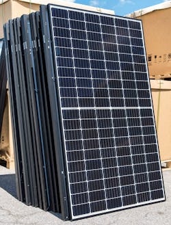

Solar panels ready for installation are shown here.
