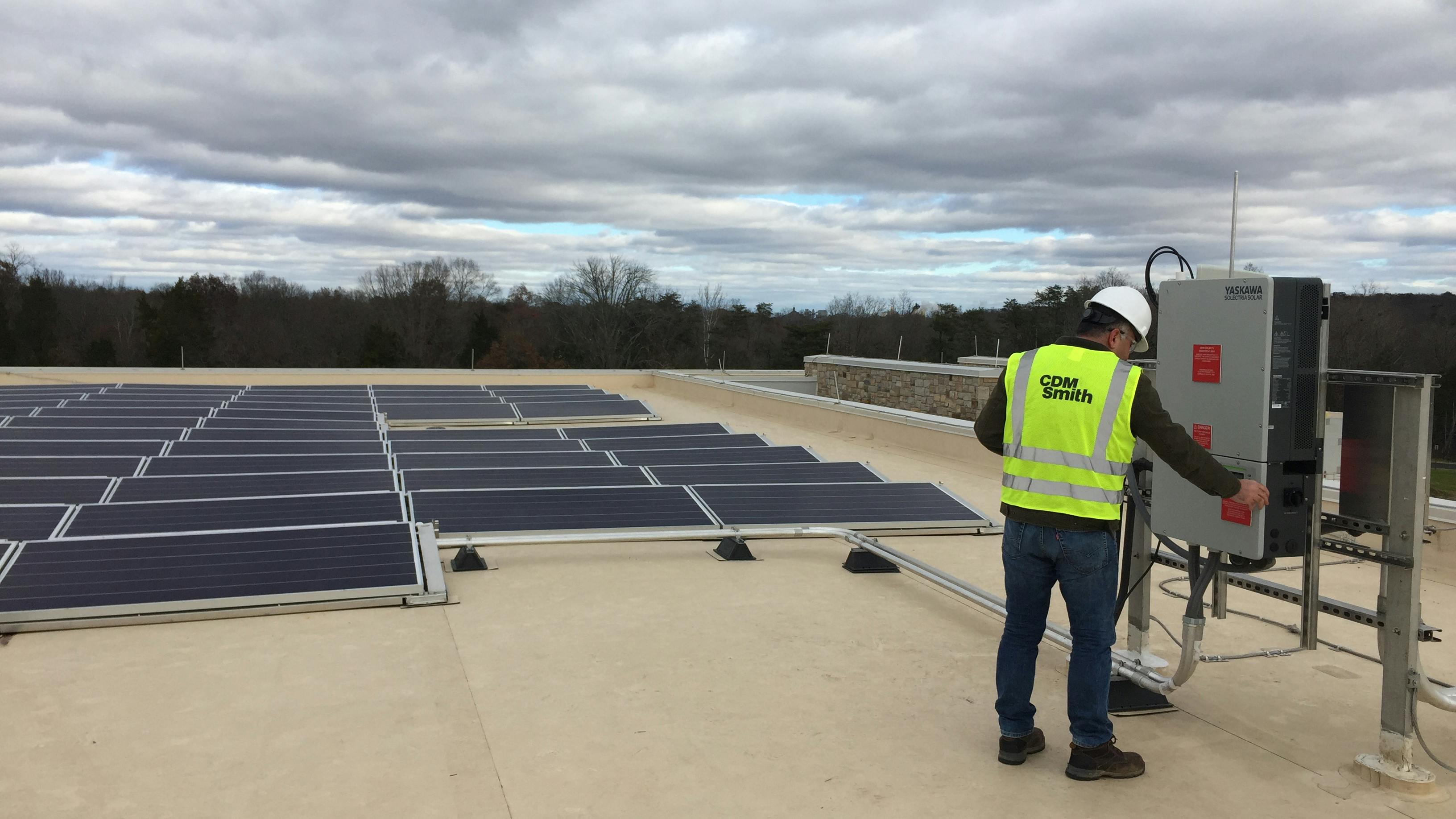

Solar PV systems
Photovoltaic (PV) systems are becoming a more common component of both small-scale and electric utility power generation assets; therefore, safe installation and compliance with the NEC are critical to ensuring reliable and long-lasting performance. Article 690 addresses conductors, overcurrent protection, disconnecting means, grounding, bonding, and labeling for PV systems. A PV system comprises a series of components that work together to produce usable electricity from sunlight. The PV modules convert sunlight into DC power, conductors in raceways carry that current to inverters, and the inverters create usable AC power for distribution. Overcurrent protection, disconnects, and grounding equipment are then applied to safeguard both people and equipment. Each component must be properly sized and installed in accordance with the tables and calculations provided in Art. 690 (Photo 1).
In PV system design, the calculations for circuit voltage and current must be precise and ensure both safety and compliance with the NEC. Section 690.7 and Sec. 690.8 address these requirements and establish a clear method for sizing equipment, conductors, and protective devices, thereby accounting for environmental and operating conditions applicable to each unique installation.
Section 609.7 outlines requirements for determining the maximum voltage in PV source and output circuits. Section 690.7(A) outlines the process for determining the maximum circuit voltage for the system — calculating the open-circuit voltages of the modules in series. Refer to Table 670.7(A) to account for the lowest ambient temperature for the installation; this provides calculated correction factors because the PV modules will produce higher voltages under cooler temperatures.
Information about a location’s historical weather and temperature can be obtained through the National Oceanic and Atmospheric Administration (NOAA). Using NOAA’s data, an engineer can determine the lowest temperature that an installation is likely to experience and, thereby, apply an accurate correction factor. Applying the correction factor to the series sum determines the highest voltage, within reason, that the system may produce. After this value has been obtained, one must ensure all equipment — including disconnects, overcurrent protection, inverters, and conductors — is rated to withstand the maximum expected voltages.
Furthermore, Sec. 690.7 limits the PV system’s maximum voltage, depending on the type of installation (e.g., a maximum of 600V for dwelling installations, 1,000V for non-dwelling, and up to 1,500V for utility-scale systems). These limitations ensure the components are within their design ratings, thus preventing insulation breakdown, arcing, or other failures induced by overvoltage incidents.
Section 690.8 provides the framework for determining the circuit currents of the PV system; doing so ensures proper conductor and overcurrent protection. Section 690.8(A) requires the maximum circuit current to be calculated with the rated short-circuit current (Isc) of the modules. That number is then multiplied by 125% to account for irradiance and operating conditions. For the PV source circuit (point at which the PV module connects to the protection device), this value is the sum of the paralleled modules’ Isc ratings entire PV output. Section 690.8(B)(1) then requires that both conductors and overcurrent protection devices be sized to at least 125% of these maximum currents, effectively applying a 156% factor between module Isc and conductor ampacity. Inverter output circuits are sized differently based on the name plates’ continuous output; also, systems with multiple inverters or storage must coordinate with Art. 705. These requirements ensure that wiring and protection are not undersized, thus reducing the risk of overheating or fire during continuous maximum exposure.
In solar PV installations, improper grounding of racking, module frames, and associated equipment remains one of the most frequent Code violations. Section 690.43 requires exposed metal parts of PV module frames, electrical equipment, and conductor enclosures to be effectively grounded and bonded (in accordance with Sec. 250.134 or Sec. 250.136, regardless of voltage) to ensure a continuous low-impedance fault current path. In the field, however, equipment grounding conductors (EGCs) are often undersized or omitted, and continuity testing between modules is sometimes skipped during commissioning. These oversights not only violate Code requirements but also create serious safety hazards by increasing the risk of shock or fire. To reinforce proper sizing of EGCs, Sec. 690.45 further requires EGCs to be sized in accordance with Sec. 250.122 and Table 250.122. When a protective device does not exist within the circuit, Table 250.122 (below) may still be applied using an assumed overcurrent device rating, as permitted by Sec. 690.9(B), to ensure proper conductor sizing.
