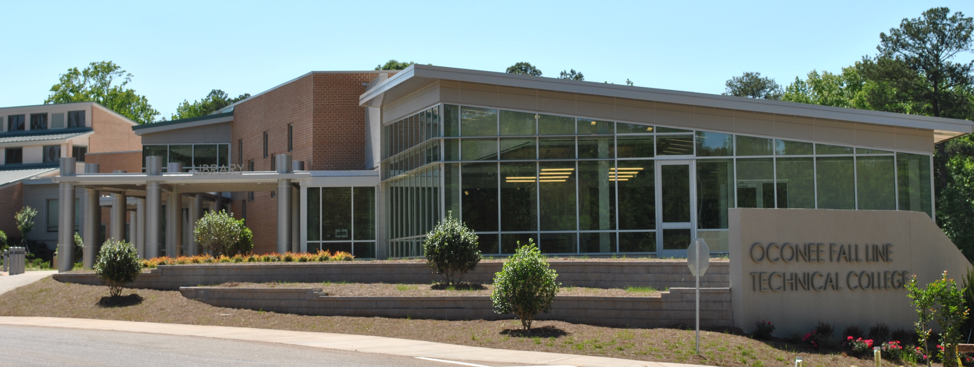

Employee Injured While Working at Oconee Fall Line Technical College
The worker was injured while attempting to connect new wiring with existing wiring that was still powered.
