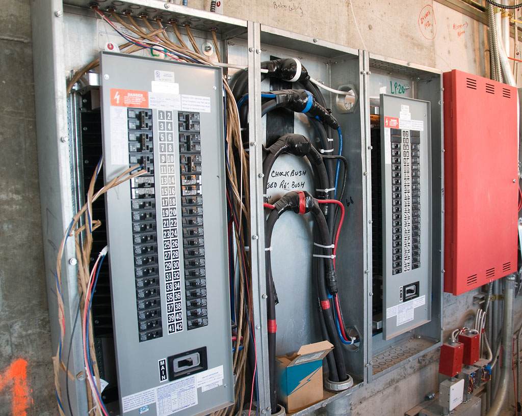

    In response to a complaint of an electrical shock injury, the U.S. Department of Labor's Occupational Safety and Health Administration (OSHA) found that a 20-year employee was injured while he performed service work on an electrical panel at a Coldwater rice-cake manufacturer. Following the investigation, OSHA has cited Basic Grain Products, Inc. for two repeated and five serious safety violations.

    The investigation also found Basic Grain Products failed to implement electrical safety-related work practices, which included no use of personal protective equipment; untrained workers; and inadequate clearance in front of electrical panels. These violations resulted in five serious safety citations. A serious violation occurs when there is substantial probability that death or serious physical harm could result from a hazard about which the employer knew or should have known.
