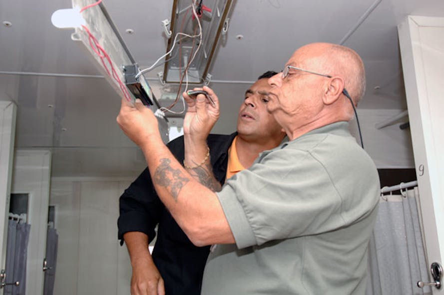

Fire Protection Specialist Tom May, left, and John “Rudy” Rulapaugh examine a lighting fixture for safety and functional use at Forward Operating Base Prosperity. Stanley Baker Hill contractors, these men are part of one of more than 30 teams that are currently conducting inspections of fire and electrical systems in Iraq, including grounding and bonding of all facilities according to the NEC. (Department of Defense photo by Petty Officer 1st Class Kristin Fitzsimmons)
Some electrical safety problems can also be traced to the Iraq electrical infrastructure. Power frequency surges, combined with haphazardly designed and constructed service to buildings and substandard fixtures, are partly being blamed for hundreds of fires. Childs, who prior to joining the SAFE effort was a U.S. Army Corps of Engineers employee working on Iraq electrical transmission system upgrades, says an unstable grid has caused power fluctuations that have a probable link to many electrical fires.
“Generators going up and down — and problems with steady voltage — have led to a lot of lighting ballast issues,” he says. “At many fire scenes, we've found ballast problems to be the cause. Part of the solution will involve putting in-line fuses to the fluorescent lighting so when there are spikes, instead of a transformer heating up the fuse will blow.”
