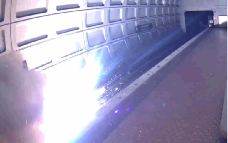

The investigation report finds that while the traction power system continues to be a concern, FTA safety oversight leadership has driven WMATA to create a safer environment for both workers and passengers. In May 2016, FTA directed WMATA to complete repairs to its TPE system on segments of the Red Line where a large number of electrical arcing events resulted in smoke and fire. As a result of WMATA’s subsequent maintenance activity, the number and severity of these events has been reduced.  WMATA experienced 18 electrical arcing events in these areas from March 1 to June 14 of this year, including four major events at the end of April and early May. Since June 15, there have been only eight relatively minor events.
“WMATA, like many legacy systems, is struggling to manage the safety consequences of aging traction power systems that have suffered from deferred maintenance,” said FTA Acting Administrator Carolyn Flowers. “Under FTA oversight, WMATA is addressing the issue, and must provide sufficient staffing and resources to ensure lasting safety improvements are made.”
Since the FTA assumed temporary safety oversight of the Metrorail system in October 2015, WMATA has reported more than 70 safety events resulting from electrical arcing in its traction power system.  Each of these events required an emergency response, and many resulted in the partial or full shutdown of a station or off-loading of a passenger train.
