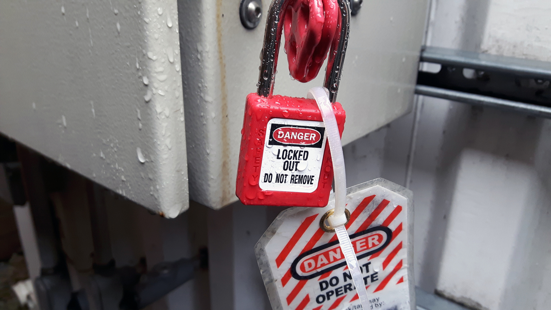

OSHA recently cited Royal Oak Enterprises for exposing employees to multiple safety and health hazards at its facilities in Branson and Summersville, Mo. Facing $339,702 in penalties, the charcoal manufacturer was cited for 19 serious violations at the Branson location for exposing employees to confined space entry, electrical, housekeeping, hearing, and forklift hazards; deficiencies in lockout/tagout; inadequate machine guarding; and failure to mount a fire extinguisher. At the Summersville facility, OSHA found 10 serious violations for electrical and forklift hazards, accumulation of combustible material and exposing employees to silica dust.
