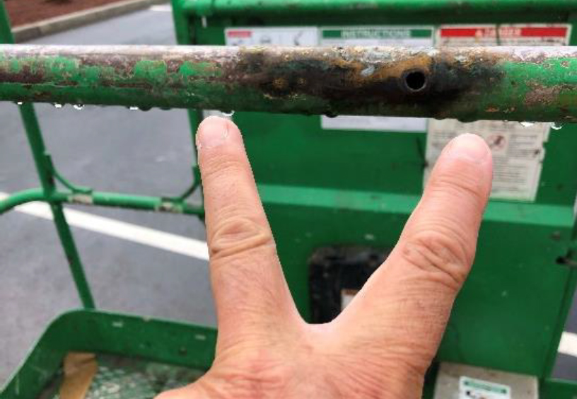

From the ground, one technician operated the lift’s controls to elevate the boom. The other stood behind the lift to check for a hydraulic fluid leak. As the technician raised the boom, it came near to the power line, but did not touch it. Electrical current arced from the line to the lift basket’s wet metal railing and traveled through the lift’s frame into the parking lot asphalt where the technicians were standing. The shirt of the technician standing behind the lift caught fire and he received electrical burn wounds to his upper body and left foot. The other technician received electrical burns to his fingers. Both were hospitalized; one worker returned to work after several days, the other after several weeks.

  • That electricity can arc, or jump, from a power line to an aerial lift without contact with the line. If any part of the lift gets too close to a power line, an arc can cause electrical current to energize the lift and run through it to the ground. This is especially true when a conductive object, such as a lift’s boom or basket, is wet.
