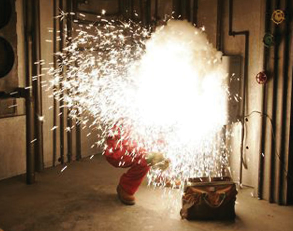

Arc flash events pose extreme danger to those working near energized equipment.
Arc flash 101
The severity of an arc flash is determined by the magnitude of the incident energy a worker is exposed to during an arc flash. The magnitude of incident energy is determined by three factors:
