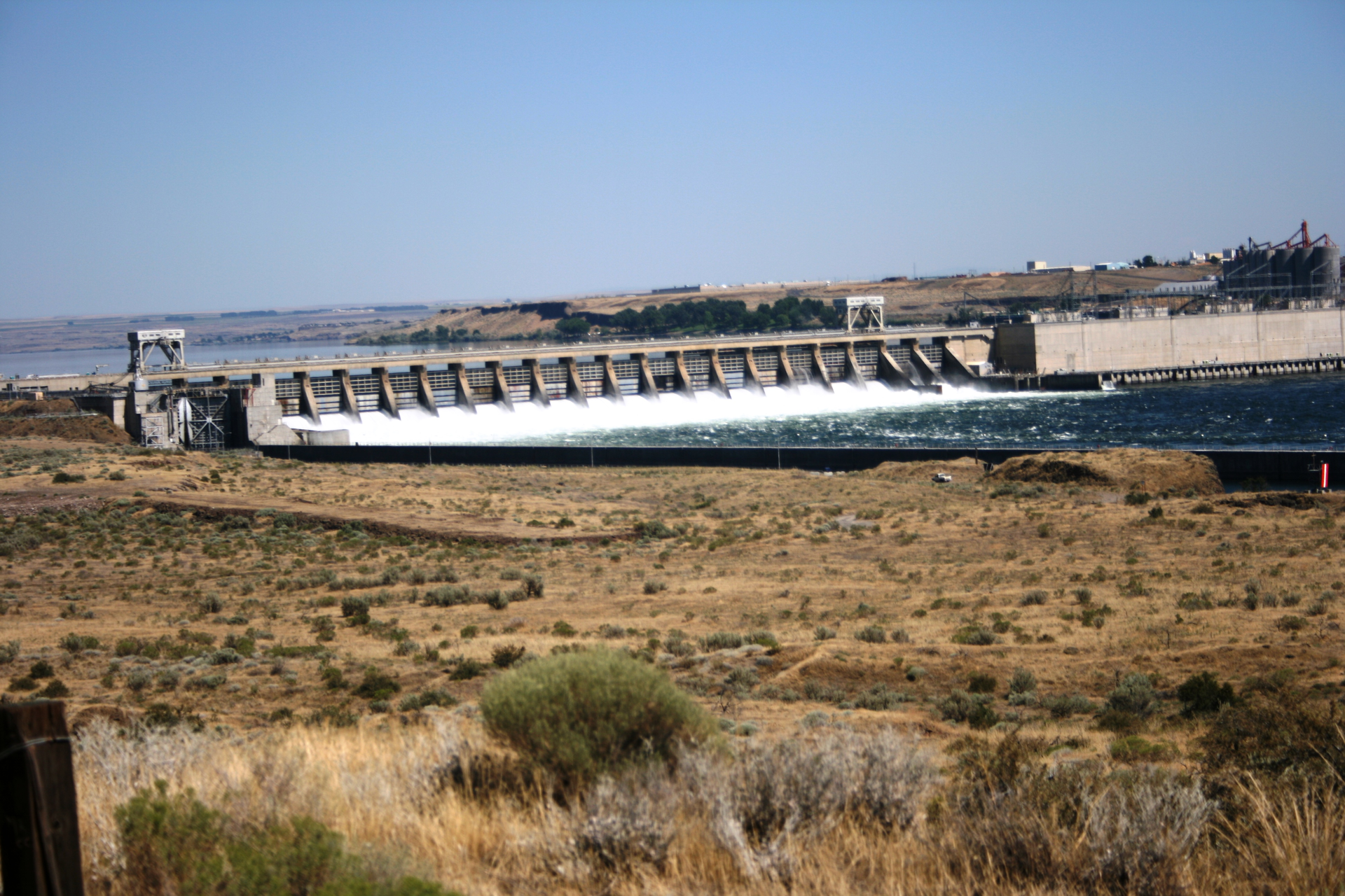

Safety Lapses in Dam Explosion That Injured Workers
The explosion at the hydroelectric dam on the Columbia River injured six workers.
Feb. 5, 2016
Human error and safety lapses led to Grant PUD employees being injured at Priest Rapids Dam last October. EC&M reported the story on Oct. 9, in which the explosion at the hydroelectric dam on the Columbia River injured six workers.
The Grant PUD recently released the findings of its investigation of what happened when the employees were hospitalized with burns suffered in an arc flash. The arc flash was because a circuit "breaker was manually slow closed while energized with unit P08 in a stopped position," according to a Grant PUD document.

The circuit breaker is on the dam’s No. 8 generator. Each of the dam’s 10 generators is equipped with the same type of circuit breakers.
