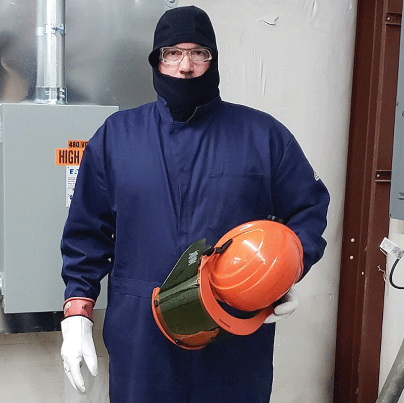

Step 2: Ensure you’re protected from head to toe.
Arc flash PPE is more than just free shirts and pants that your company makes you wear to work. Depending on the exposure level, there are several other requirements to ensure you are completely protected when exposed to an arc flash event. Let’s start with your head and work our way down to your toes.
Head protection — A hardhat is required for all levels of arc flash incident energies. The hardhat should be electrically rated and within the manufacturer’s recommended lifecycle date. Also, when using the NFPA 70E table method, for energy levels of 4 cal/cm2 and greater, you must wear either an arc-rated balaclava or arc-rated hood.
Face protection — Your face will need to be protected from two dangers: severe heat (molten copper, flames, plasma, etc.) and tremendous amounts of light energy from infrared to ultraviolet. You will need to wear an arc flash face shield with balaclava or arc flash hood to block the light exposure.
However, these face shields and hoods are not designed to protect you from the potential of projectiles. Therefore, you must also wear safety glasses under the hood or face shield to fully protect your eyes.
Hearing protection — Hearing protection is required for all arc flash hazard levels. The sound created from an arc blast can reach up to 140 dB, which is comparable to hearing a military jet aircraft take off from 50 ft away. The recommended practice is to use ear canal inserts. A common question is: Will ear plugs melt in an arc flash? The reality is that ear plugs should never be exposed to an arc flash because they will either be under the balaclava or inside the arc-rated hood. However, the scientific answer is that the most common styles of ear plugs can withstand direct exposure to significant incident energies before showing signs of melting. But let’s not test that ourselves — keep yourself and your earplugs covered.
Torso, arm, and leg protection — Your arms, legs, and torso should be covered by some combination of long sleeve shirt, pants, or coveralls. Your shirt sleeves should be rolled down. All buttons should be buttoned, and all zippers closed. Your shirt should be tucked into your pants. Not only should no skin be exposed, but there also should be no exposed non-arc rated materials. All the outer layers must be individually rated greater than the potential incident energy exposure.
Hand protection — You should always wear gloves that provide the appropriate level of arc flash protection. According to the NFPA 70E Table 130.7(C)(15)(c) Note (d), the combination of rubber insulating gloves with leather protectors satisfies the arc flash protection requirement.
Foot protection — Leather footwear will provide the protection needed for your feet. Tests have shown that even with steel toe leather boots, the leather provides sufficient protection to avoid any temperature increase inside the boot during an arc flash event. Keep in mind, however, that shoes should be completely leather and not a combination of leather and synthetic materials like many of the current popular safety shoes.
For all items of PPE, visually inspect them to make sure there are no holes, tears, or any other damage that may compromise the item’s ability to withstand the hazard to which you will be exposed. With everything on, make sure there is no exposed skin or exposed non-arc rated materials. Also, ensure everything fits properly. It is best if the clothing is not too loose or too tight. A slight air gap between the shirt and your skin adds an extra buffer between you and the heat to which you could potentially be exposed. Also, keep in mind that if the task requires fall protection, you should be using an arc-rated harness and lanyards. Anything worn on the outside of your arc flash PPE should also be arc rated.
