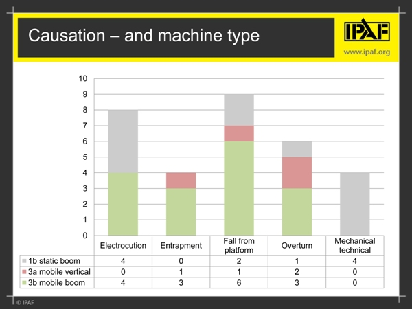

There were 31 fatalities worldwide involving mobile elevating work platforms (MEWPs), also known as aerial work platforms (AWPs), in 2012, according to preliminary results of International Powered Access Federation's (IPAF) accident database. The main causes of these fatalities included: fall from platform (9), electrocution (8), overturn (6), entrapment (4), and mechanical/technical related (4).
Almost half of the number of reported fatalities (16) involved booms (3b). Eleven fatalities involved vehicle mounts (1b),  and four involved scissor lifts (3a). About two-thirds of the fatalities (20) occurred in the United States, the largest single market for powered access equipment in the world. Three fatalities were reported in the Netherlands, two in the United Kingdom, and one each in Australia, Austria, Canada, Singapore, Spain, and Switzerland.
