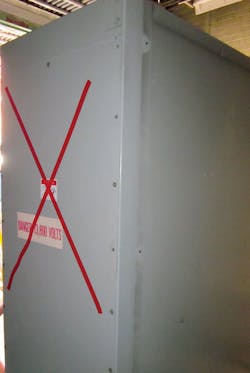

Company electricians completed the isolation of the load break switch by racking out and performing LOTO on the MV breaker in another building. They also peeled the red tape “X” off of the back of the new load break switch that had been isolated in the new substation. (This “X” is used to alert people that this part of the substation is energized. Because this load break switch had been de-energized and placed under LOTO, the “X” was removed.) Company electricians then removed the back panels of the locked-out new load break switch [36-4], and unbolted the cable terminations after verifying that the circuit parts were de-energized using voltage test equipment. At this point, they told the electrical contractor the circuit had been de-energized/locked out, and left the area. Contractor personnel placed their locks on the lock box for the circuit.

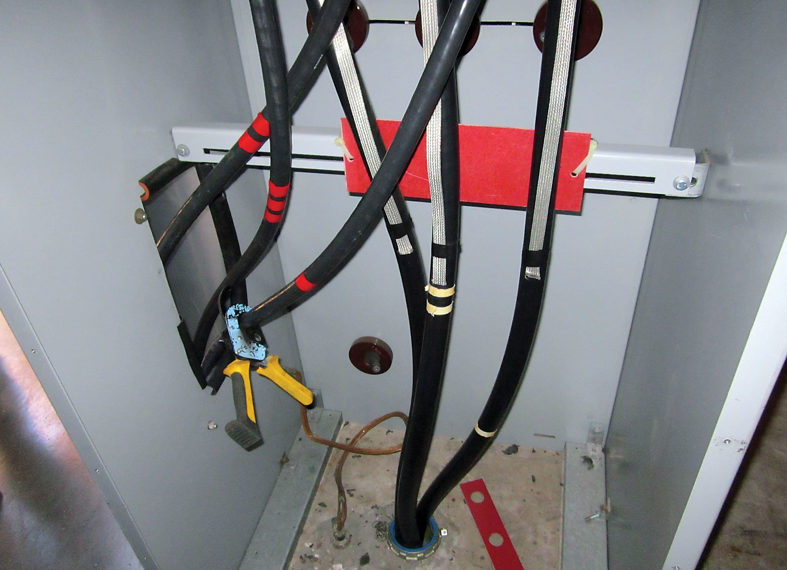

Contractor employees began cutting the conduits and cabling below the de-energized old load break switch [36-3] in Bldg 12B. The contractor lead electrician asked the electrical helper to get his ratchet cable cutters, “go to the far load break, and cut the 4/0 cables.” (He was being asked to cut the MV terminators off of the cables in the back of the locked-out load break switch [36-4] so that they would pull out of the conduit easily.) The contractor crew, including the lead electrician, began wiping lubricant off of the cables in anticipation of pulling them out of the conduit.
The helper promptly went up the south stairway of Bldg 12B and entered the old substation room (Fig. 2). He passed by de-energized load break switch [36-3] (which had the wires hanging out and the back taken off), noticed the door leaning up against the back wall, and continued to far load break switch [46-3] in, which was energized. He noticed that this switch was locked and tagged in the off position. He also saw the red tape “X” on this load break switch (Photo 4) but made the incorrect assumption that this device was de-energized. The helper took a battery-powered drill and removed the bolts from the back cover from the energized load break switch and placed the cover to the side. When he began to cut the cable in the back of the load break switch, he heard a loud “pop” and saw a flash. Realizing something was very wrong, he went to the south stairway to tell the contractor’s lead electrician that there might be a problem. A problem it was, indeed. Company operations personnel quickly showed up asking what had happened, considering that a significant portion of the chemical manufacturing facility had lost power when this fault occurred. Despite the disruption and downtime that followed, the miraculous thing was that the helper walked away from the incident without a scratch.

One positive result of this near-miss was that the ground fault detection and relaying system on the MV power circuit breaker was tested and proved to work as designed. The protection system detected the phase-to-ground fault, which resulted from the cable cutters slicing through the copper shield on the 13.8kV cable and penetrating the inner conductor. The circuit breaker opened quickly, removing power from the fault and preventing a large arc flash event.

Photo 5. Cable cutters embedded in 13.8kV cable.
There was a lock and tag on the front of load break switch [46-3] — left over from the removal of the old substation equipment — where the cut was made (Photo 5). In actuality, this load break switch was only being used as a splice box. Thus, the lock and tag were meaningless. However, when the helper saw the lock and tag, it further convinced him that it was okay to remove the back from this load break switch — a decision that substantiates the fact that he should not have been considered a “qualified” electrical worker.

The taped red “X” system also proved woefully inadequate as a method to inform workers of energized parts. A better system — one that is NFPA 70E-compliant — should have been used.
