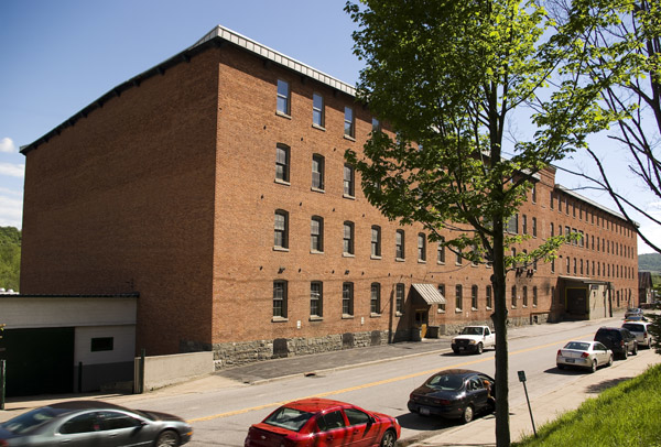

The Occupational Safety and Health Administration has cited Burrows Paper Corp., based in Little Falls, N.Y., for repeat and serious safety violations at two of the company's work sites. Burrows faces $298,100 in proposed fines following inspections by OSHA's Syracuse Area Office.
"The proposed fines reflect both the gravity of the cited hazards and the employer's refusal to use required safeguards," said Chris Adams, OSHA's area director in Syracuse. "Workers could have been injured in falls, electrocuted or suffered other injuries because of the employer's repeated failure to ensure a safe workplace."
The inspections were initiated as part of OSHA's Site-Specific Targeting inspection plan. The inspections were conducted because the company's injury and illness rates exceeded national incident rates for 2009 and 2010. Burrows is a food grade paper and packaging manufacturer that has five paper machines in four mills located in New York and Mississippi. It employs approximately 700 workers.
During the inspection of the company's Mohawk Valley Mill at 489 West Main St., OSHA inspectors found an electrical hazard related to the use of electrical equipment not approved for the location. Additionally, inspectors identified six repeat violations for safety hazards related to additional electrical hazards.
The inspection of the East Mill at 730 E. Mill St. found two serious safety violations for exposure to combustible paper dust, electrical issues and a malfunctioning exit light.
