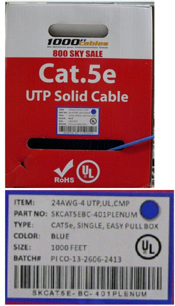

The following is a notification from UL that the communications cable identified below may pose a fire hazard. The communications cable does not comply with UL's safety requirements and is not authorized to bear the UL Mark for the United States.
Name of Product:  Communications Cable, Type CMP
Manufacturer:  Caleb Cable Industrial Ltd., Sheung Shui, N.T. Hong Kong
Hazard: This communications cable is missing the appropriate level of flame retardant. This may cause an increased risk of fire.
Identification:
On the cable:  The surface of the cable jacket displays the following description:
CAT5E 350MHZ BARE COPPER CMP PLENUM UTP 4-PAIR 24AWG EIA/TIA-568-B.2-1 (UL) E334179.

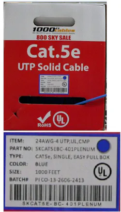

On the packaging:  The packaging bears an unauthorized UL Mark and the following:
                                                1000ftcables
We Optimize your Communication Needs
                                                800 SKY SALE
                                                Cat.5e
                                                UTP Solid Cable
                                                RoHS
                      ITEM:  24AWG-4 UTP,UL,CMP
                      PART NO: SKCAT5EBC-401PLENUM
                      TYPE: CAT5e, SINGLE, EASY PULL BOX
                      COLOR:  BLUE
                      BATCH #: PICO-13-2606-2413
