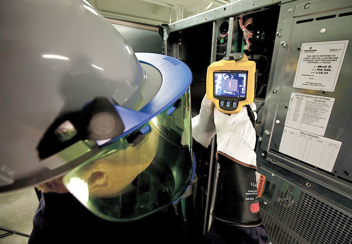

Consider maintenance generally. Your electrical services firm sends you on a thermography job. Being conscientious, you ask your host about their feeder maintenance program and how many feeders were identified as suspect during the last insulation resistance testing work. The reply is they don’t have such a program and don’t perform insulation resistance testing. So you have no clue about the insulation integrity of the cables you’ll be exposing yourself to during the thermography. You must stop at that point to conduct an electrical hazard assessment on the presumption that all of the cables are faulty. You must assume the equipment is in an abnormal, damaged condition unless you have maintenance data showing otherwise.
Some people believe it makes more sense to assume in the other direction. An abnormal condition is, by definition, less likely to exist than a normal condition. But this isn’t about guessing how likely the abnormal condition might be. You don’t want to walk into an abnormal condition unprepared. You want to be able to walk back out, so you prepare accordingly.
