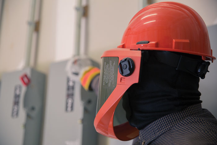

For an effective electrical safety program, build the overall safety improvement process into the technical electrical safety program (Photo courtesy of e-Hazard.com).
From a program perspective, a company should quickly standardize approaches, such as developing energized work permits, implementing training programs, conducting engineering studies, and adding arc flash and shock hazard labels to equipment. But these projects take time, and companies are often concerned that they will buy more PPE than they actually need in the meantime. However, this isn’t typically a valid concern. Our firm has had clients who had employees die while they were commissioning arc flash studies, so don’t ignore the PPE — but don’t stop there either.
