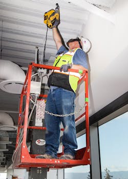

    Consulting the standard’s prescription for controlling silica exposure in drilling, Bill Sandvik, safety director at O’Connell Electric Co., Victor, N.Y., concluded that specially designed and equipped tools and accessories that capture and contain dust would likely be the answer.
    “We’re not in position to put our people in respirators, and we can comply with the standard without doing that,” he says. “We’ve already purchased about a dozen drill devices and a half-dozen large dust extractors, and we’re in the process of fielding the equipment that we’re going to use.”
    To extract residual dust, a HEPA-filtered vacuum must be used to capture it — either alone or with the use of compressed air or a hole-cleaning kit. Also, when drilling indoors or in enclosed areas where dust can build up, contractors must provide additional exhaust. Respiratory protection is not needed if all these steps are followed.
    New types of drills and vacuum attachments provide a ready way for contractors to capture and contain silica-containing dust, but tool changeovers could be complicated. In addition to the cost, issues of tool availability, manufacturer brand compatibility, and getting workers trained with and comfortable using new tools and related procedures are tangible obstacles.
    Valderrama, whose firm had about 80 rotary hammer-compatible HEPA-filter vacuum attachments back-ordered with a supplier ahead of the effective date, worries about the universal adaptability of tools. There’s not only the issue of potential conflicts arising from different tool brands, he says, but also corded and cordless tools/accessories having to work together.
    “The tooling-up process could turn out to be a rabbit hole,” he says. “If you have a lot of tools of different manufacturer origin, they may require different attachments to meet the required engineering controls. We’re standardized, and all of our tools are the same make and model, but there may be other guys who will have to make some decisions about a mix of different tools and attachments that aren’t in compliance.”
    After determining that vacuums it had for working with lead wouldn’t be adaptable, O’Connell, Sandvik says, decided to purchase from a single supplier the needed new containment tools that fit around a drill. A universal device, it will accept any drill brand, eliminating the need to buy an entire family of tools specifically for that product. O’Connell also purchased hollow-stem drill bits that capture dust for situations when the other device might not work well.
    “I’m impressed with the products that are out there for handling this,” Sandvik says. “When you use this equipment properly, almost nothing gets out.”
