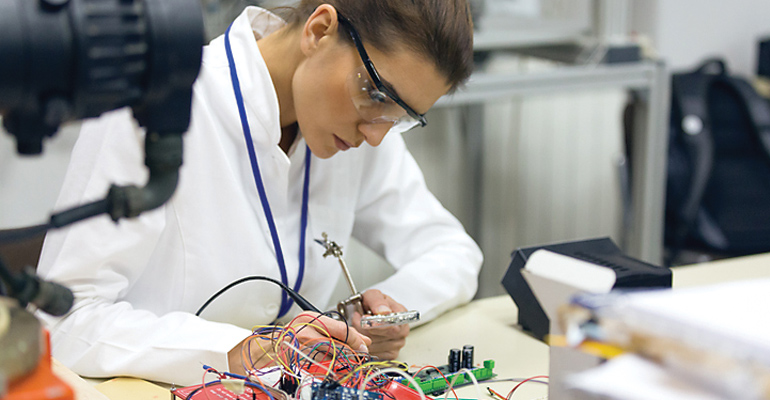

ESD-safe workstation
ESD workstations should be designed for just one person (Photo 1). Multiple people working at one station will greatly increase the risk of ESD events occurring. ESD workstations should be situated in the EPA. Here’s a list of nine key elements to incorporate in an ESD workstation:
• Bench matting — Multi- or single-layered with a finish made from antistatic and static dissipative materials with synthetic rubber.
• ESD bags — Static shielding, conductive, and antistatic bags that protect contents from the damage of electromagnetic wave and static.
• ESD screwdrivers — Static dissipative materials that protect sensitive equipment.
• Earth bonding points — Stainless steel stud with mounting screw ring terminal to allow connection of wrist straps and grounding cords.
• Earth bonding plugs — Incorporates banana sockets and a 10-mm male steel stud.
• Conductive component boxes — Conductive coating with faraday cage protection and antistatic foam.
• Conductive PCB rack — Conductive properties protect circuit boards during transportation and storage.
• Conductive brushes — Conductive nylon and plastic brushes minimize static charges when cleaning PCB and other sensitive components.
• Ionizing blower — Ionizes a targeted workspace to eliminate static during production.
Make sure the workstations are equipped with grounding stations and that personnel are using grounding straps at all times. At the very least, the ESD workstation needs to be equipped with ESD matting, bonding points, and earth bonding plugs.
