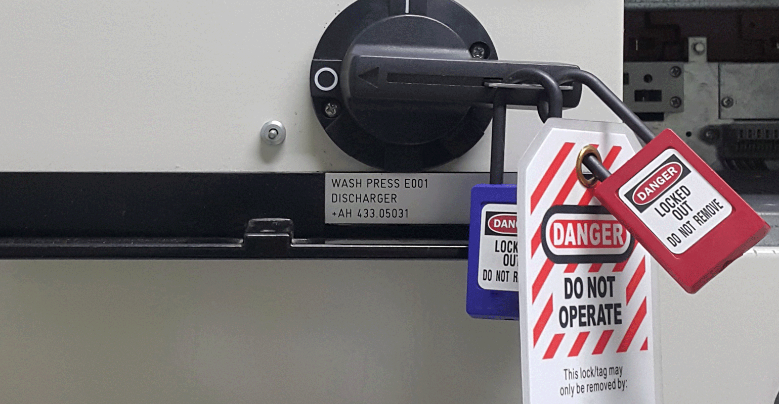

Re-organization of Art. 120
Previous editions of NFPA 70E had all the right pieces for establishing an electrically safe work condition, but it needed a little tweaking for all the requirements to fall into the right order. The technical changes within Art. 120 are relatively minor in the grand scheme of things, with the exception of permission to use the aforementioned permanently mounted test device for verification of absence of voltage. However, by re-arranging the order in which tasks are listed in Art. 120, the process for establishing an electrically safe work condition is easier to implement.
Previously, the Article started out with the section on verification of an electrically safe work condition. This was leading to some confusion as users of NFPA 70E were jumping around Art. 120 to find the different requirements they needed (as they were following the steps outlined in Sec. 120.1). With the new arrangement, however, Art. 120 is reorganized to increase usability and to provide a more logical flow with the following section layout:
• Section 120.1 (Lockout/Tagout Program)
• Section 120.2 (Lockout/Tagout Principles)
• Section 120.3 (Lockout/Tagout Equipment)
• Section 120.4 (Lockout/Tagout Procedures)
• Section 120.5 (Achieving an Electrically Safe Work Condition)
Now all the requirements for each of these important topics can be found in one place. In addition to reorganizing the requirements that belong in Art. 120, certain requirements were removed and relocated to other sections of NFPA 70E as appropriate. For example, lockout/tagout training and auditing requirements were moved into Art. 110 under the appropriate sections that deal with training and auditing.
