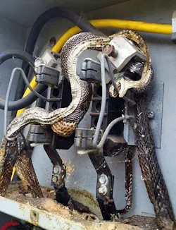

Snakes
Like rats and mice, snakes often enter electrical boxes in search of food (Photo 2 and Photo 3). A snake’s climbing ability makes it easy for them to slither up and down electrical conduit. Once they enter the box, they are large enough to get shocked. Once shocked, all that will remain is the snake’s dead carcass and electrical controls that no longer operate. In 2017, a snake entered a substation and knocked out power for 22,000 customers in the Jacksonville, Fla., area.
