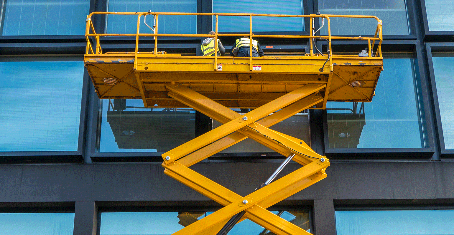

The familiar scissor lift is one type of aerial. Compared to scaffolding, scissor lifts and ladders provide more flexibility of use. Compared to ladders, scissor lifts (they have platforms with railings) and scaffolding (they typically have larger platforms with railings) provide more fall prevention. Scaffolding provides fall prevention once you are at elevation, while a scissor lifts provides it when you close the gate behind you.
