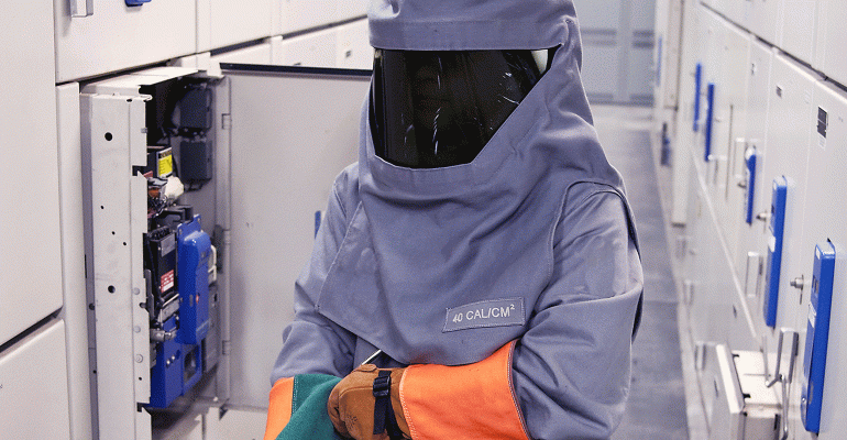

You’re the onsite supervisor for an important project with a new, out of town client your company worked hard to get. The first day onsite, you and the crew are getting set up when someone points out the wrong arc flash PPE was packed. You need the 40 cal kits, but have only 31 cal kits. Much of the work will be done with covers removed, and powering down isn’t an option for the thermography.

Joe’s idea is a bad one. If it is unsafe to work, you don’t take a vote. You make it safe to work. John and Cathy are both correct to some extent; each has hit on part of the solution.
You can probably buy that day of delay with no adverse effect on the schedule if you can move tasks around. Anything that requires up to the 31 cal kit can be done while awaiting the 40 cal kits. But you shouldn’t just shuffle the work around, because the client is also making accommodations per the existing schedule.
You first step is to identify which tasks you can do with the PPE you have and how much time those will take. Next, contact the home office to alert them to the problem and describe your solution.
What should happen next is your project manager calls a quick phone or video conference with your client, explaining the problem and asking “if there’s any reason we can’t make some workflow adjustments”. Then your onsite contact should meet with you to agree on the details.
