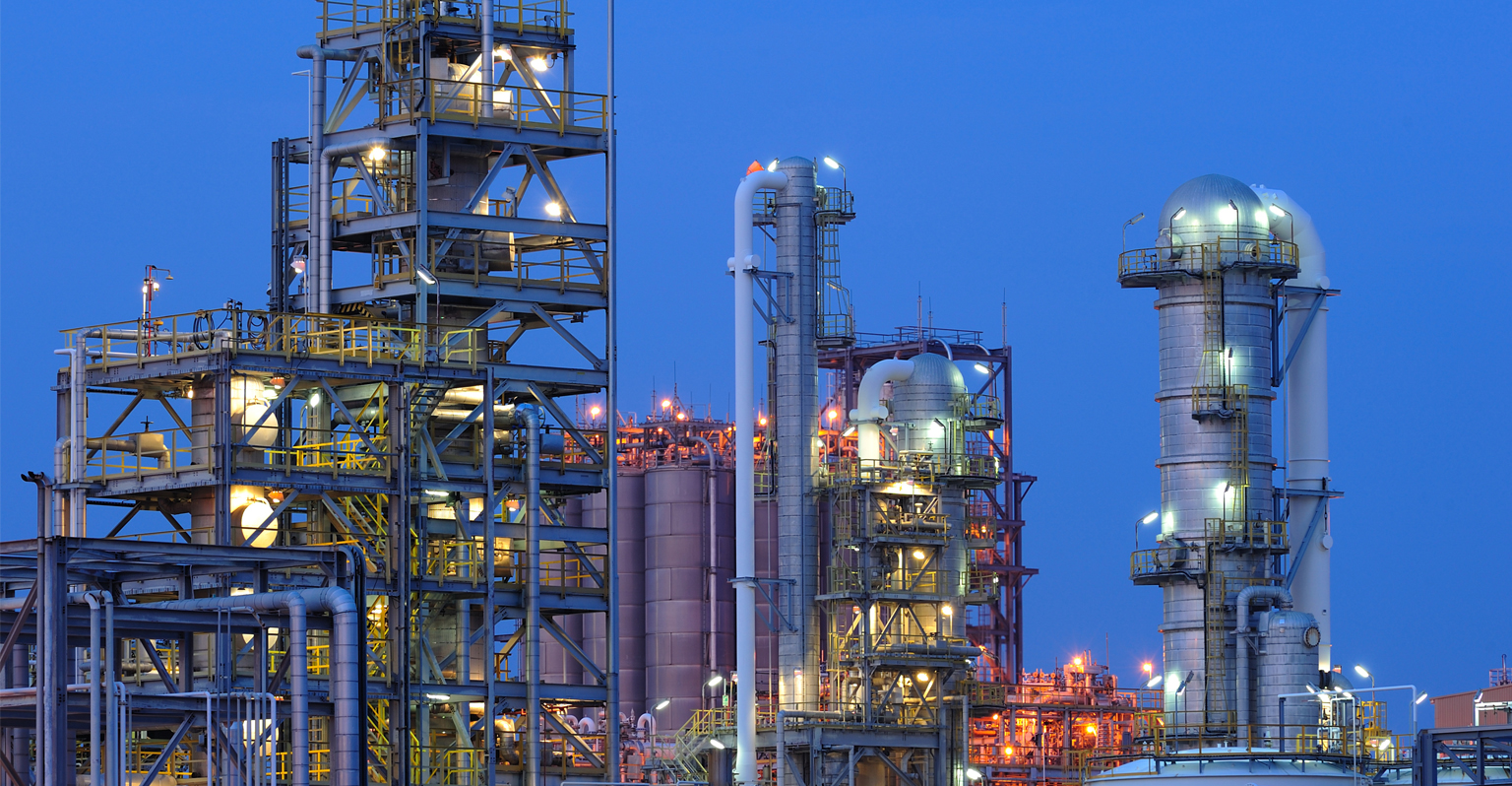

    Wherever flammable gases, dusts, or vapors accumulate in sufficient concentration, there is a risk of fire or explosion. The risk can arise in environments as diverse as a chemical plant (see Photo), a flour mill, a water treatment plant, or a vehicle paint shop. All it takes to set off an explosion is a source of ignition from an electrical spark or even a hot surface. Therefore, those responsible for electrical design, installation, and maintenance play a key role in protecting people, plant, and product from risk.
