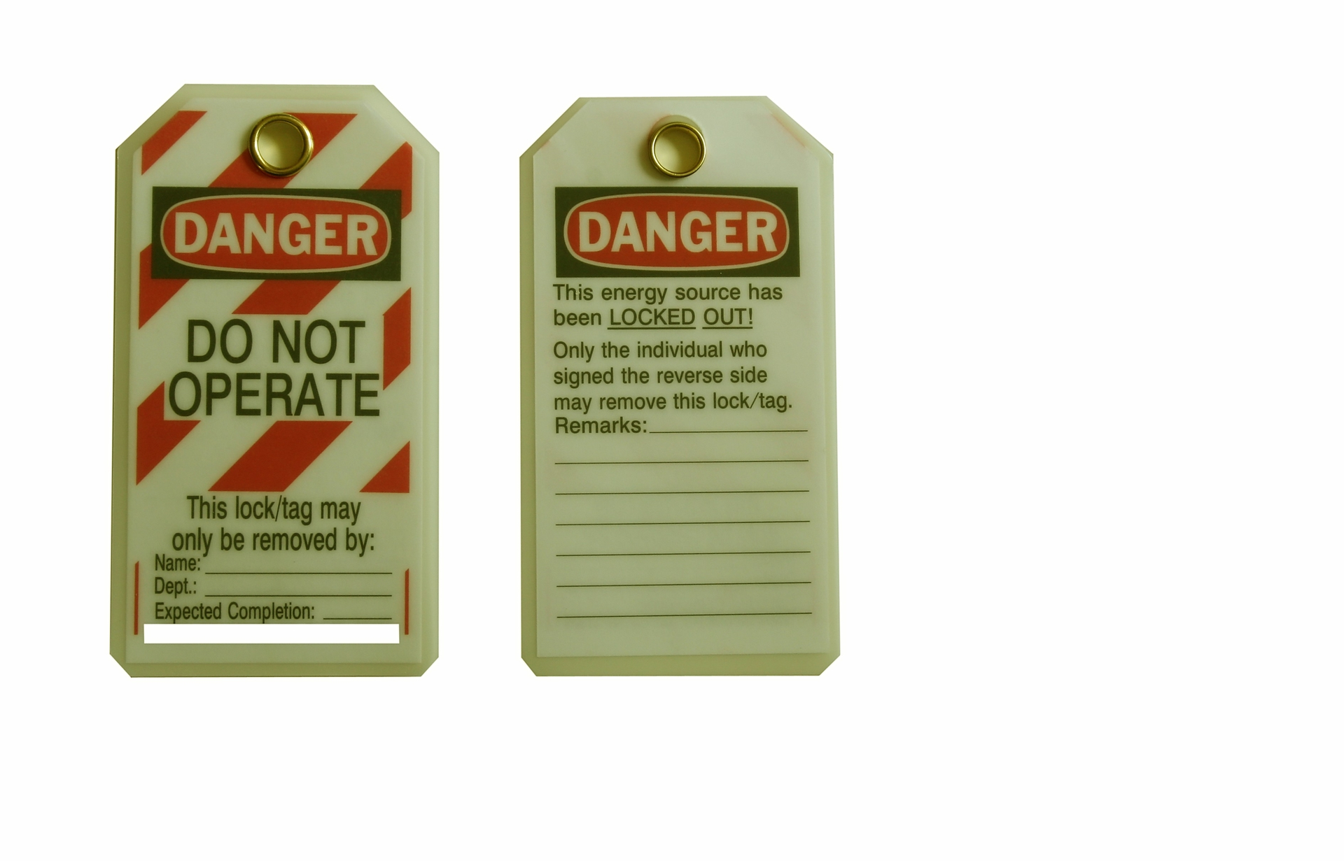

Obviously, some things must be energized for certain tasks to be performed. Aside from that constraint, de-energization is the choice. And that is true even if the whole lockout/tagout process takes longer than the task to be performed.
Perceived time-savings should never be a consideration when making safety choices. In most cases, it is illusory at best. Getting an energized electrical work permit authorized can take more time than shutting something down.
It’s not a simple decision to make. Some of the considerations:
  • Does the work require the equipment to be energized? For example, taking voltage measurements, taking current measurements, testing subsystem operation. If so, it’s an Article 130 job.
  • Does the work require the equipment to be de-energized? For example, replacing busbar connections, testing motor rotation, performing insulation resistance testing. If so, it’s an Article 120 job.
  • Does operations want the equipment out of service to avoid potential quality problems during the work? It may be a mix of Article 120 and Article 130.
  • Is the equipment such that de-energization may cause serious problems? For example, it’s a glass plant or a data center. If so, it’s an Article 130 job.
  • Would it be easier to work it hot? That’s not relevant.
