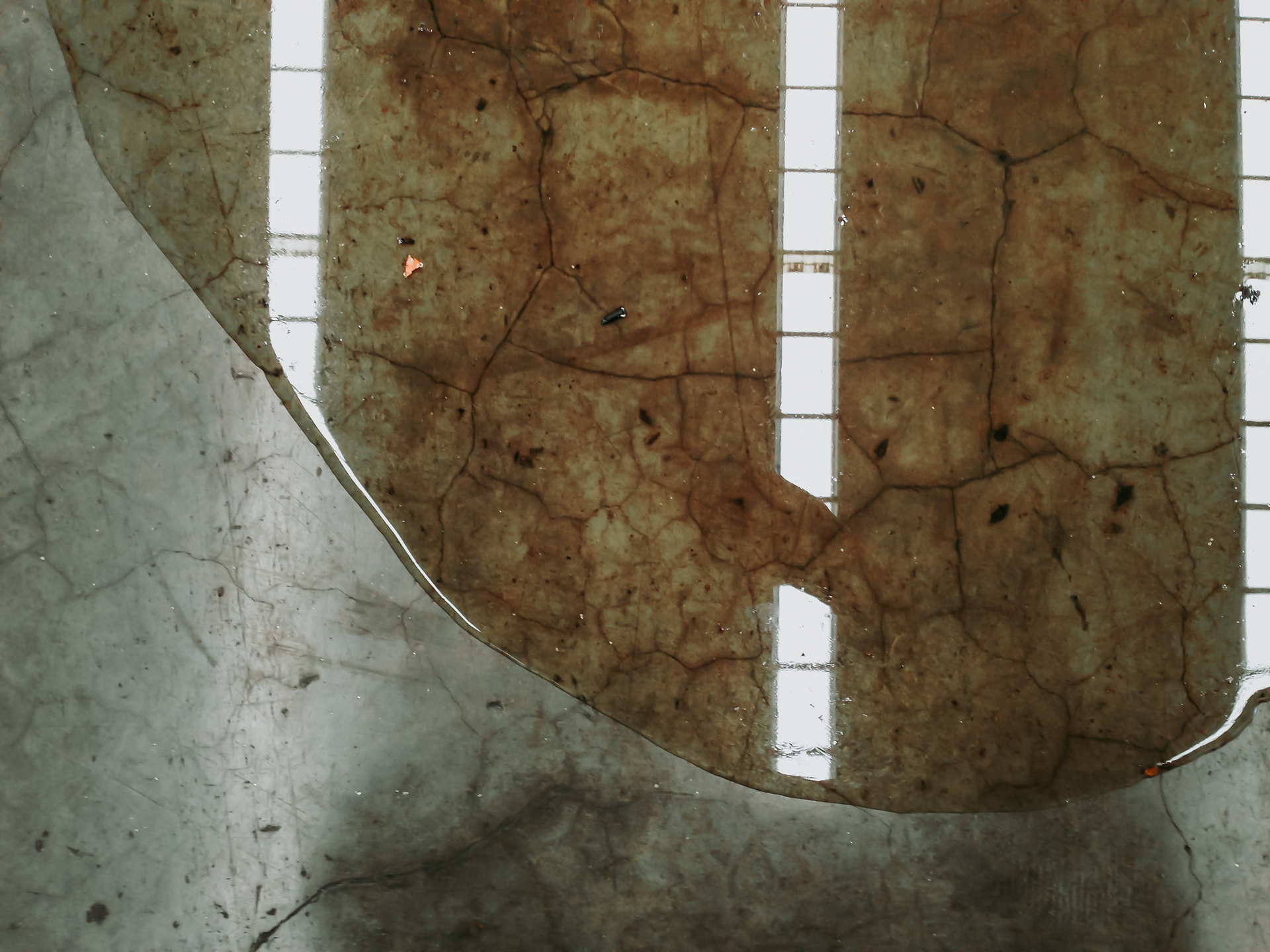

Many times on a job, a safety problem arises. These can usually be dealt with quickly. For example, there’s a small spill; you clean it up. The lighting is inadequate; you set up a portable light. You notice a portable cord running across the steps you need to use; you unplug it and restring it so it’s out of the way.
But what if there’s a big spill? Per the spill procedure, you leave the area and report the spill to the spill response team via the shift supervisor. And then you notify your supervisor. Your supervisor thanks you for the update and ends the call. Without reassigning you. What just happened?
